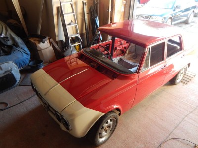

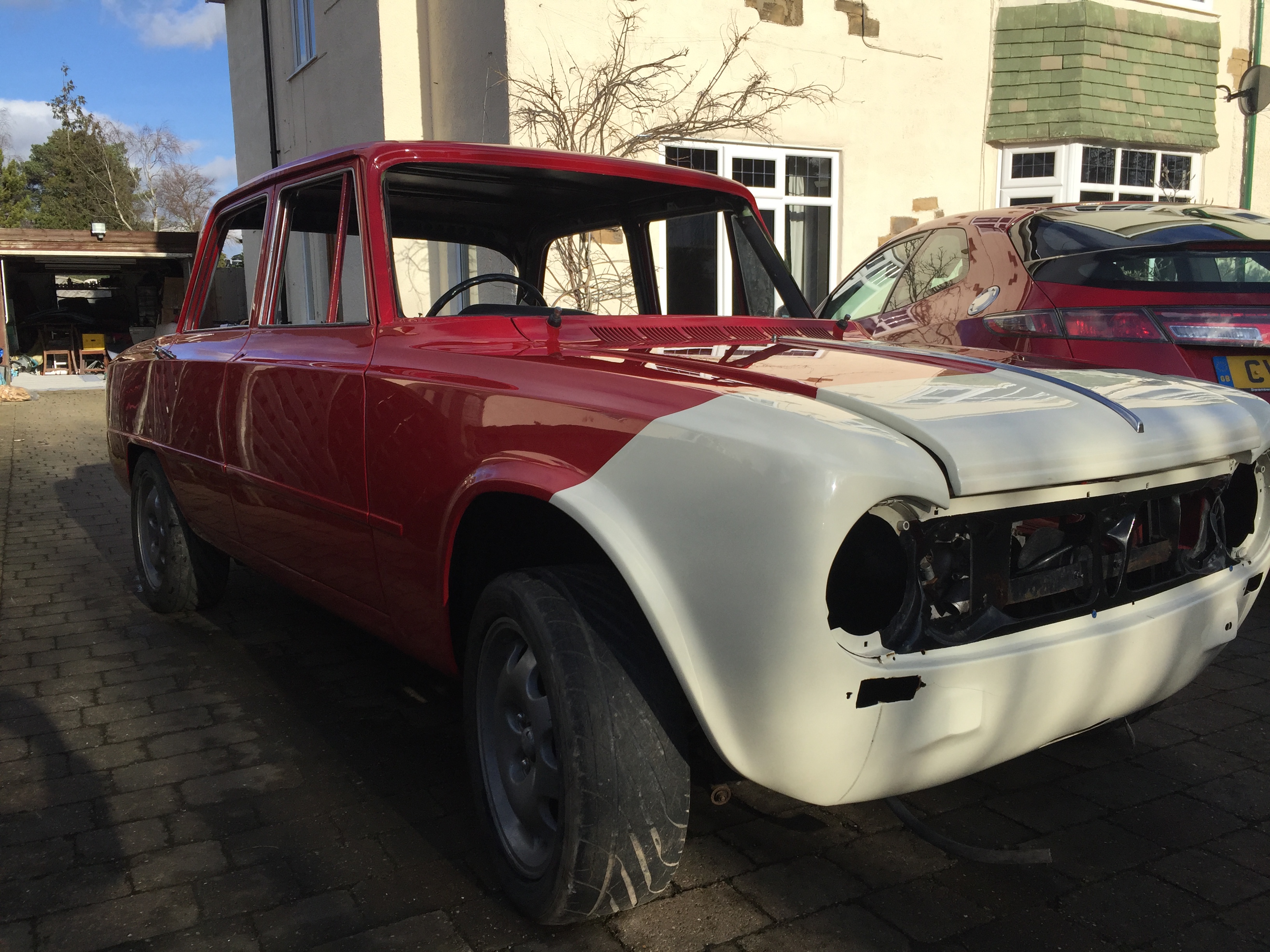

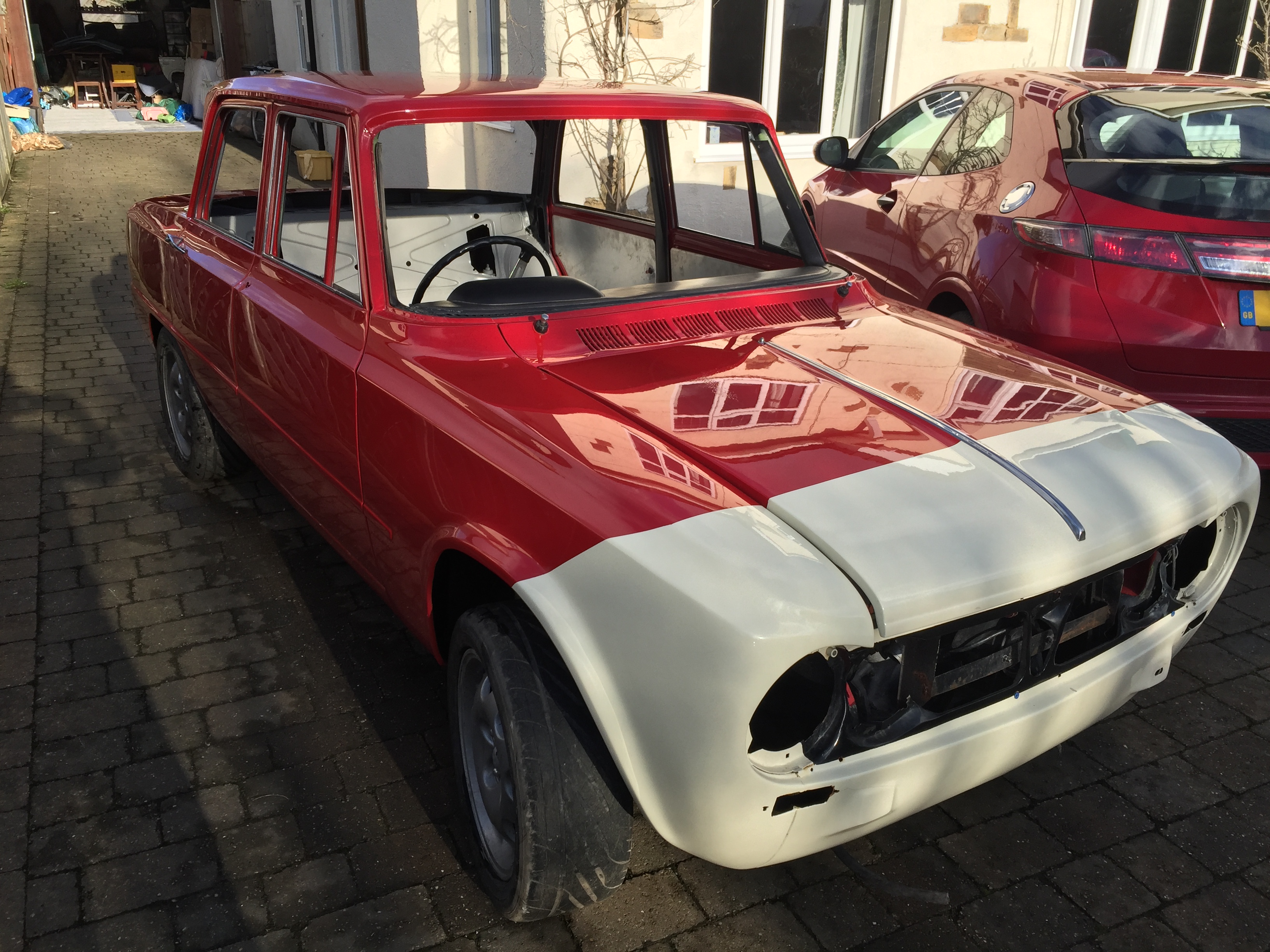

Well, after shrew delivered her to me about a month ago, this was the first time she's been out of the garage for an inspection. I'm pretty happy!
I wiped her down with a soft damp cloth and inspected the paintwork. I'm now expert but not bad, a few chips, a couple of very small marks. A thin mist of white over some panels that polishes off.
The bonnet is bad however, you don't really see it easily, but lots of little bumps/blisters in the middle of the bonnet. I took a few snaps, and am going to touch in the little chips and want to find a good painter for the bonnet - any recommendations let me know.
Then it's a full set of rubbers and find a missing quarter light, and fit the glass and doors properly.
A couple of pics if anyone is interested:

Looks like a very sound car inside and out - very nice

Lovely , very smart.

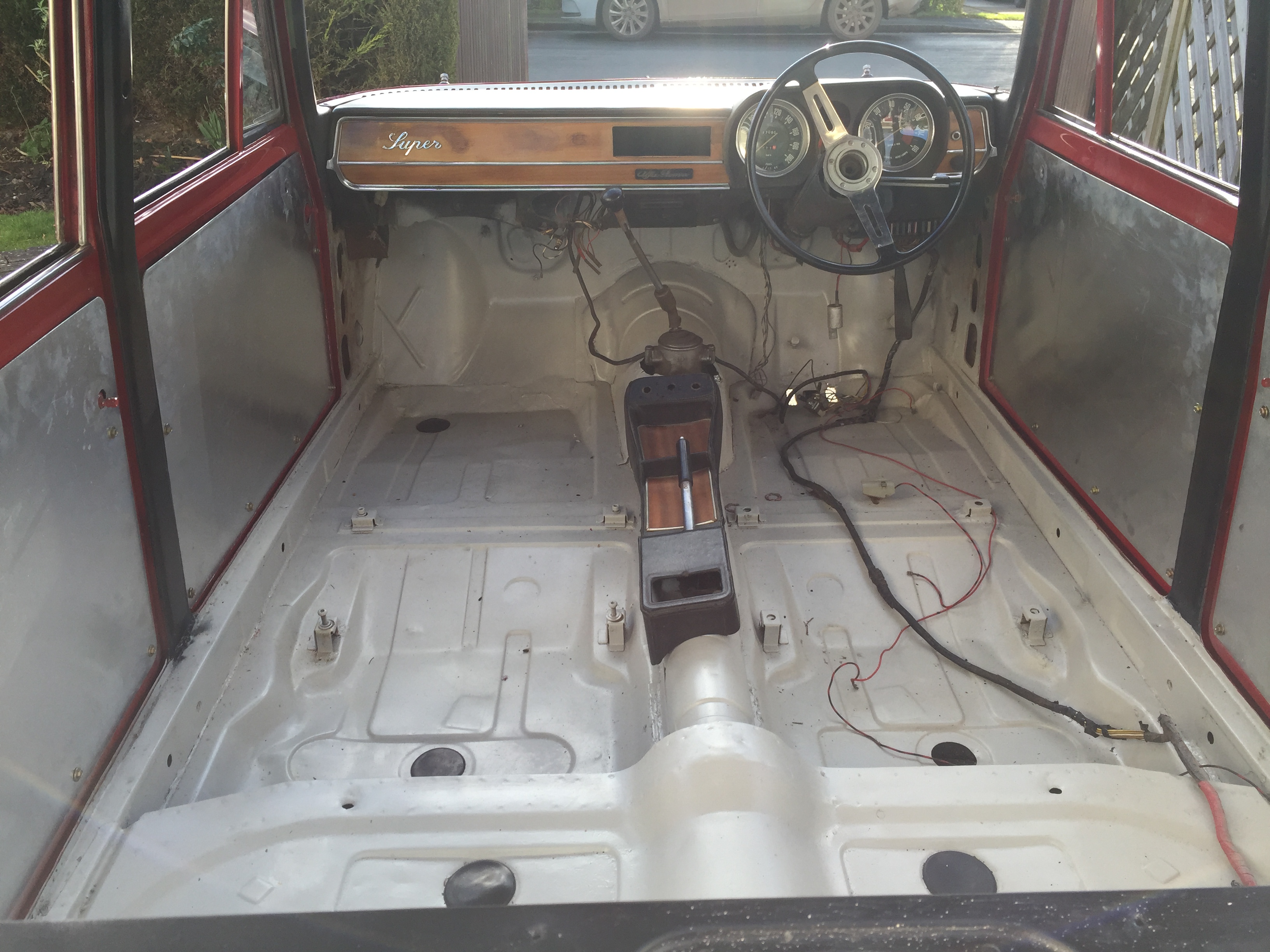

Hate to point out the elephant in the room, and can understand your concern about the paint chips,
but you seem to be missing a complete interior !
Watch out for door seals as some of the new ones are too fat or springy and do not allow the doors to shut easily, so if you have old ones keep them.
Also from my experience I would put some anti rust around the lip, the petrol tank sits on whilst it is in its currant condition.
Good luck with it all, should be a lot of fun. What engine is in it ?
